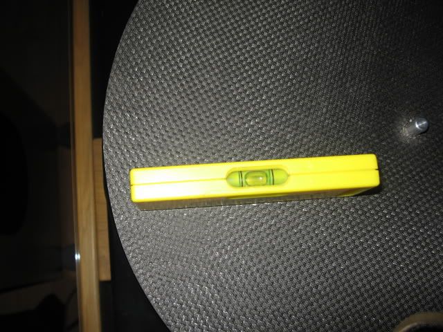

    Firstly, before setting up, i made sure my Spacedeck was level, and got the right 222mm bearing to spindle distance.
    Also, i made sure the armboard and arm tube itself was level completely, as this does throw out allignment and all other things holy in Turntable adjustment.

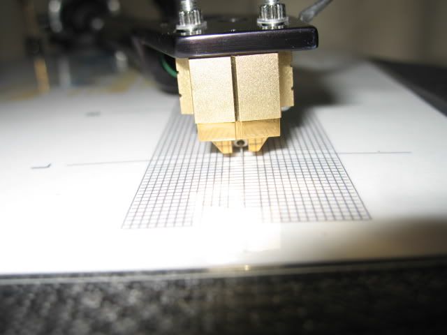

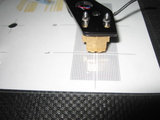

    Once levelled, It was time to set up the Cart (A Denon DL304 low output mc). Again, this was easy, as i had a protractor, scales and a cart fitting kit. There is a small hole in the front of the headshell that the stylus needs to line up with, and this will correspond right down onto the allignment guage/protractor.

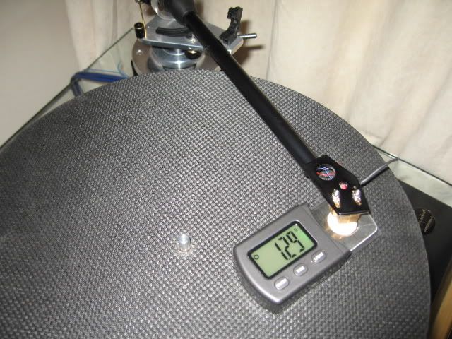

    When done, the cart was aligned using the protractor, and also weighed using the digital scales, remembering the scales are slightly higher than an LP when it`s stiing on the platter. This will throw the cart weight out slightly, and the cart will weigh lighter when the cantilever is on the LP....only slighly, but does make a difference. The cart optimum tracking force is 1.2-1.4 gramme, so it was set at around 1.3.
    Alignment and azimuth where also set spot on, as again, this is essential.
