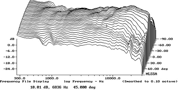

Dali speakers are not like other speakers, they are designed for no toe-in. On axis they sound way too toppy, they're flat at 45º and thus put out a lot much energy to the sides than typical loudspeakers:
DALI Rubicon 8, lateral response family at 50"
https://www.stereophile.com/content/dali-rubicon-8-loudspeaker-measurements
Aye Tuga .. I realise that. I would still experiment though because if they are close to side walls then the reflection may be even worse than sitting on axis .. It may prove to be a wasted exercise but you never know until you try. Hence why just a smidgeon of toe in may be fruiful (or it may not) - costs nothing to try

If the tweeters deliver at their best 45 degrees off axis then it won't be a surprise that the left speaker is getting a lot of reflections from the nearby wall. I guess the trick will be toeing in the that speaker enough to mitigate the wall reflections but not enough to put the listening position on the same axis as the tweeter. That'll be the sweet spot.
