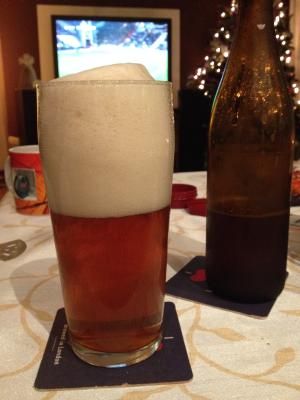

Nice topic.
I discovered real beer only in my mid 30s, when I visited my brother in London and got the taste of ales. Before that all I knew were lagers :doh:
Right now ales are my favourite kind of beer... closely followed by porters and stouts. This is what got me into home brewing. While some bitters can be bought in Poland, they are 3-4 times as expensive as domestic beer and there are not many of them.
I went to a local free workshop organised by the Polish Homebrewers Association. Very recommended, if your local association does something like that. I attended a short course on all-grain brewing and tried this at home. Well the first results were not stellar, but at least I know what I did wrong :) I guess I went too far with steeping which made my beer taste astringent... anyway, a few days ago I tried the beer which I bottled six months ago and it was quite nice, perhaps the head was too impressive!
Unfortunately the biggest problem is finding free time to brew... I hope to get some time after Xmas.

Excellent stuff.
Try reducing the amount of sugar when priming. This isn't a science as it varies with the darker malts and the style. My rule-of-thumb is; the darker the beer, the less priming it needs.
If you do over-prime, you can always chill it down and drink it like a dark "lager".

Yes it may look like it's too much priming sugar. However, this is beer which I bottled half a year ago. The head was one or two fingers in the first months, I found this huge head in the last two bottles only... after six months. Maybe the yeast in the bottle ate through remaining sugar over all those months, I don't know. I tried to prime conservatively, bit under 3.5g per bottle IIRC.
Anyway the taste of my first efforts in brewing changed over the months, improving. I remember three or four weeks after bottling, all I could smell or taste was yeast - this went away after two months. I used Danstar Nottingham dried yeast, but I would really want to try liquid yeast when my brewing skills improve a bit ;)
