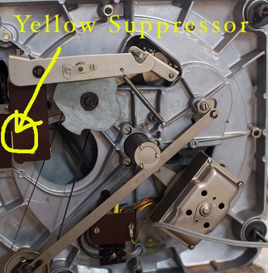

Nice find Jack! The top platter and Thorens arm + armboard should pay for a fair amount of upgrading - it's worth checking the suppressor which are often bulging / shot:
The silicone motor suspension grommets work well, beware of replacement idler wheels - They are very hit and miss
You got it Matt, the suppressor has wet itself all over the place.
