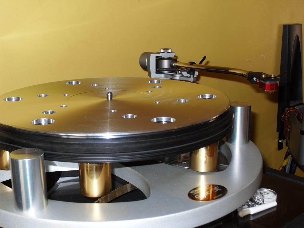

Here's mine>>>>
Personally I think the Jelly is much more of a visual treat on a Gyro than the Technoarm & to my eyes at least just looks right on a Michell deck. :love: :love: :love:
